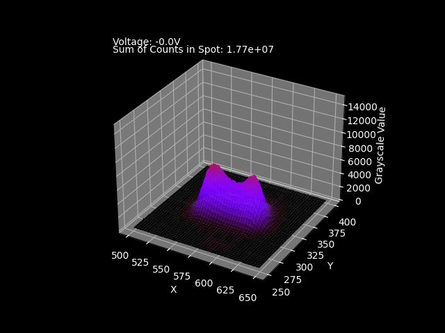

First, let’s look at a visualization of a gridded Minifocus tube’s X-ray spot taken on a production tube at Micro X-Ray, using our pinhole spot photo measurement system with no grid voltage applied. We can distinctly see two lobes in the spot. The total intensity of the spot can be determined by summing the total number of counts in the image, 1.77e7.

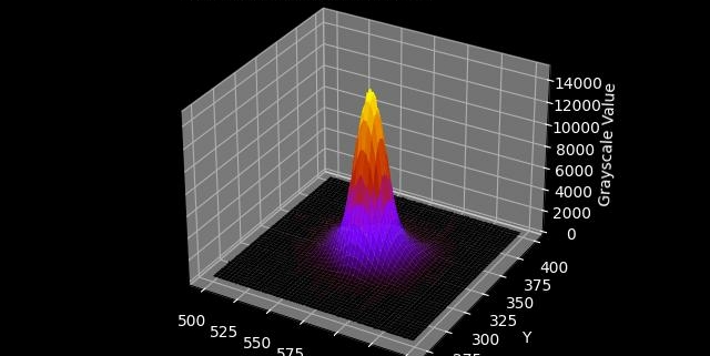

At -40V, the X-ray spot is now a sharp spike, with very steep sides and an intense center. Note the total count rate still remains unchanged, despite a very different shape than the spot with a 0V grid value. We are not adding X-ray flux, we’re simply focusing it in the center of the spot.

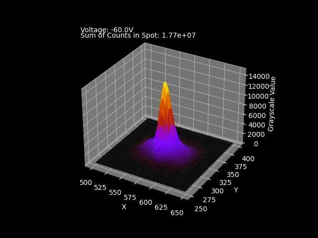

And finally, at -60V, we can see the center intensity fall slightly as the wings of the spot increase – this tells us we’ve applied too much voltage to the grid. Again, the total flux intensity remains unchanged, but over focusing the beam results in a less than optimal distribution of the available flux.
