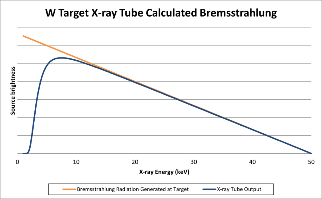

The upper limit of the X-ray tube’s energy output is set by the excitation voltage of the source, and the lower limit is set by the inherent filtration of the tube, in the example below we see both the Bremsstrahlung generated at the target face, along with the output of the X-ray tube with the 254μm Be window’s inherent filtration taken into consideration.
The voltage applied to the X-ray tube and the choice of additional filtering materials are carefully chosen to produce X-rays with the desired energy spectrum for a given imaging sample. Often in imaging applications, the characteristic lines of the target material are filtered out to ensure a clean Bremsstrahlung radiation pattern for optimal imaging of the widest possible array of samples.
